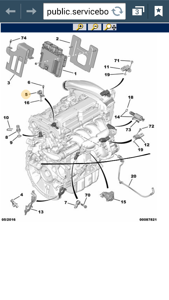

Here are some pictures of where the sensors are, maybe try changing the sensor?
These are for the 156 bhp manual but I don't think these will be different to the automatic version, but if yours is automatic I can put those pictures up as well.
Thanks tianorth that is a handy diagram, i have already changed the cam sensor

That is shocking that you had to pay for that imo. See the attached pic for the position of the solenoid. I'm going into the stealer next week for the ecu software upgrade recall, i'll make it clear then that if it does turn out to be a problem with the chain then i wont be paying a penny and see what they have to say. mine is a 2011 no extended warranty and 53k
