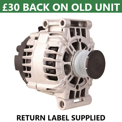

Napa Alternators are selling on ebay & listed as rated for the R June 2013-15 Reg engine size 199KW 270HP 5FG £284 reduced from £445.74

able to source the mitsubishi one? is this the one you have? .PEUGEOT RCZ 1.6 THP 156 200 270 NEW OE ALTERNATOR
I found the advert. It says in the advert not compatible with Bosch. It's a Bosch one that has come off my car.
2,608
816
Yeah its an odd one why they stipulate you need like for like replacements when an OEM unit is rated for the size of Engine
