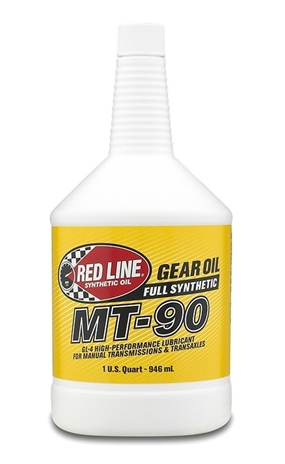

I would say that about 1.5 litres came out, looking brown, as in the video. No metal filings on the magnet topped plug, but a layer of grunge. I put back 2.2 litres of this stuff.
I am aware that manufactures do not fill tranny boxes to spec fill. Seen it before. They might save half a litre on each car, but if they make 100,000, then that's 50,000 litres!
Took the RCZ for a spin, and yes the shifts are smoother and more precise. It is the precision that I noticed and liked the most. THP200 has just turned over 52,000 klicks (32,500 miles).
