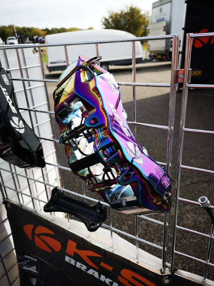

Or you could get some of these babies....
These are from K-Sport who are based at Bradford.

The K-Sport system includes
Two part discs,
8 pot pistons and calipers,
Braided hoses.
All for £1850.
Which when you consider the above posts, makes this a viable option for a complete system, which you can transfer to another vehicle by just buying the inner bell to fit new car.
