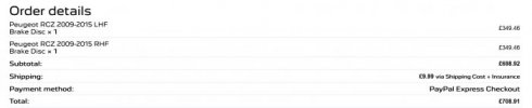

Bit late to the party but cheapest place I found was peugeotpartsdirect.co.uk for the disc’s, brought the SS pistons and seals from Godspeed and local powdercoater done the callipers
